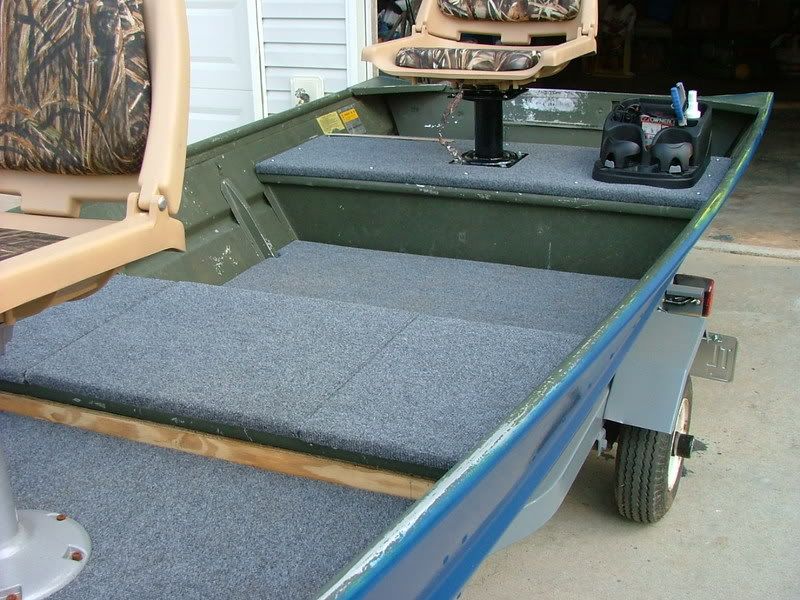

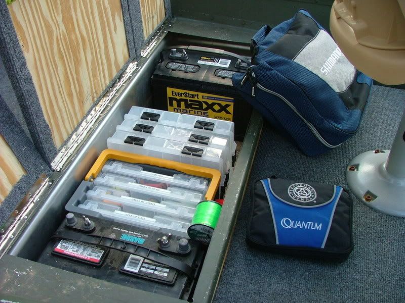

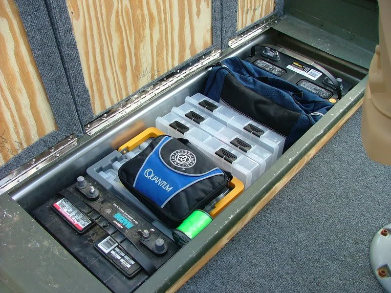

While the enamel was drying this evening, I decided to take all the stickers off the boat. Not something I want to do everyday.... I finally got most of the glue off with mineral spirits and some finger skin (literally). I'm going to sand it down and prime it with zinc chromate and then a few coats of Brightside. I think I'm going to paint the inside as well. I'm planning on putting floors in, as well as cutting out 2 holes in the middle seat for 2 batteries for my trolling motors.

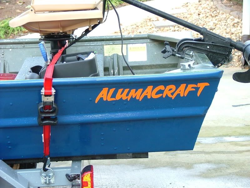

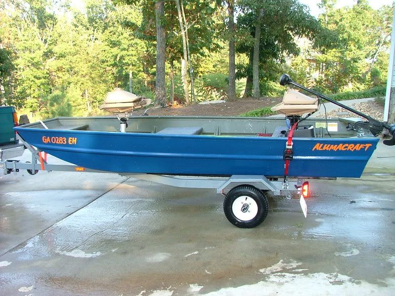

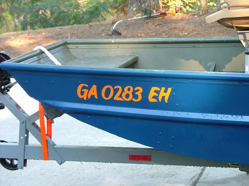

1st coat of top paint on... Electric Blue - definitely electric! I don't know what I was thinking when I picked this color out. I wanted burgundy, but they didn't have it. Oh well, I'll make it work. Probably will put some custom lettering or something on it to make it blend in more. Doesn't look too bad sprayed either, not to mention it only took about 5 minutes.
(forgot to fix the links when I moved them in Photobucket... here they are again)
So you painted this outdoors, under trees and a spray paint can....
You must be very good at painting....
Looks good.
