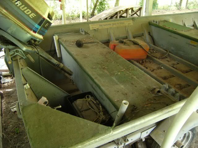

All of the junk is out and either hauled off or stashed elsewhere. I have to admit (while hanging my head :oops: ), this was a great opportunity to get rid of an eyesore that had grown in the back yard. Pic from the front of the boat.
Middle bench towards the stern. Gotta love the green astroturf-colored carpet. I don’t think they made outdoor carpet in any other color back then.

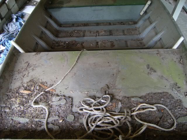

And the back.
From the stern towards the bow.
I hope “is on the rise again” applies to the boat.
The floor between the benches.
