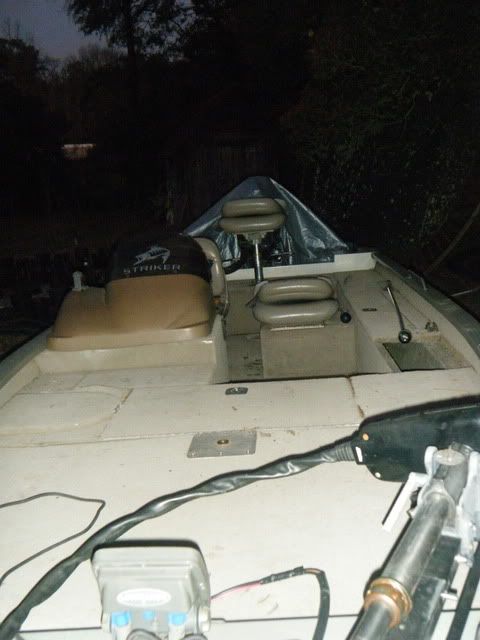

another veiw of the front storage(w/latch) livewell and "the toilet"
i am extending the front deck 27'' in this 24'' wide ally way. the new livewell is going under here against the console. i am mounting a horizontal rod holder on the outside of the rod locker and cutting a tunnell under the deck for them. it still leaves plenty of foot room for the passenger and its a fishing boat not a cruiser. i have a cooler that stays under the consonsole out of the sun.
the neew deck comes up the back of the seats. 30'' from the current old edge.
you can see that U shape is welded structure,foam and fuel tank so it isnt going any where. new storage goes inside there and will be around (18''x30'')2. those big seatpost and mounts are gone. changing over lock-n-pins 3/4 system.

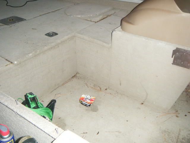

i have gained so much confidence doing this project.i now know everything about my boat as far as routing, design and repair access. this g3 is built like a tank. all decking is 3/4'' wood and the deck frame is welded 1x2. it is also very easy to work on. i completly took it apart with a phillips srcew drive and boxcutter.
at this point all carpet and wood is out exept the floor. you can see in this photo the left corner shows where the deck meets the rodlocker.
im cutting a oval hole for the rod holder on the outside. then im taking out the plate and foam block on that side so i can put a 8'rod in the main locker and a 7' in the new holder.
i am not taking foam out ofnthe boat. im put i somewhere out of the way and as close to were it came as possible to keep the factory ballance.im also adding foam in some to so it should be better than i found it.

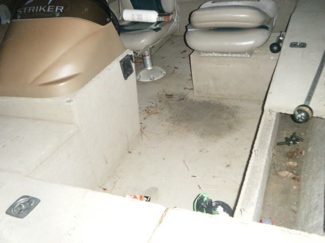

i thought it might have drainage problem as the floor never truely dried.and by what i found under the front storage tub.
raised the jack as high as possible and it went nowhere......and heres why.
Image g3 didnt think giving the water anywhere to go was need in a boat! the metal pipe in the photo is the drain for the port livewell. just below the photo bottom it is aluminum plate on top of the foam till 4'' from the transom. so it presents a extra challenge
