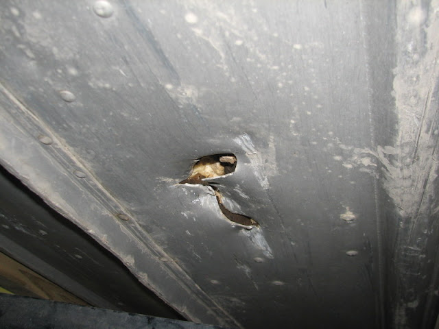

Then, last summer I got hung up on a sharp rock or metal fence post and produced this gash:

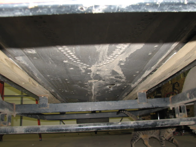

The bottom is pretty beat up in general as you can see from the long view of the above gash:

I removed the gas tank and got it down to where I could access "the gash" and confirmed all the foam under the floor was water-logged. It had been out of the water since last summer, and if you squeezed the foam, water came out.
