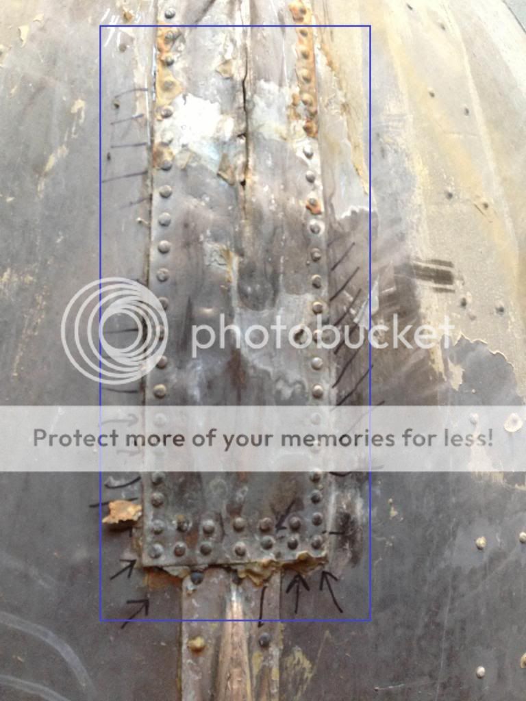

The large red circle is the main crack, and will be tig welded. The small red circle is the other crack I found...much smaller but will still need welding. The green circle is to show the that riveted seam..and it leaks alot across the whole seam..even with the junk from the PO.
The blue rectangle shows the main problem area....how would you fix this?
1) Do I weld the 2 cracks, replace each rivet and seal with steeflex over top of it all? Will that be enough?
2) Weld the entire seal where the rivets are now all the way around the rectangle piece of aluminum(edge where marker lines point to), and also replace the rivets inside the welds...then steelflex?
3) Form a new piece of aluminum to go over what is currently there, extend wider by an inch on each side, and fully weld it in...covering over the entire area with a new peice of metal.
Need some advise here! :?

Hey man, as far as jb weld is concerned, if you do it right it will probably outlast whatever its on. Huge chunks of the cavitation plate on my 140hp suzuki was busted off when I got it, I rebuilt it with an alluminum plate bolted to the underside and jbweld formed and sanded to near factory on the top, that was about 3 years ago. All the rivets on the underside of my 14ft jon weredone about 3 or more years ago still no leaks. A hole in the head plate of my 15 horse mariner was plugged and about a 3inch broken piece of the block on the same engine was re-molded a year or so ago and still working great. It really is amazing stuff so long as you take your time and let it set.

Looks like you have your work cut out for you. Its hard to say what the best thing to do is .Its probly gona take a little trial and error . I think I'd try to weld what you can and reset and seal the rivets .

Thanks Guys!! I will have to give that some thought, and also see what some others have to say as well. Was there a special type of JB weld to use FB?

I use regular jb weld, they have jb kwik that dries faster, and water weld that can be applied wet or under water... the regular stuff is the strongest. It takes a while to set, check out their website, they have a lot of great info on there

Do yourself a favor ( and I don't mean to be-little anyone else s opinion); But if your planing on keeping that boat for any time; Lay off the JB Weld. It will hold for a while, but I guarantee it will eventually fail in this application. The Cracks if yo don't want to pay a welder, use aluminium patch, rivets and a good amount of 5200 and you'll never have another issue with it. The bottom of the transom is fine I guess with the JB Weld on the outside since your going to Steelflex over it (I just hope with the cold waters you run in it doesn't just pop /crack under rhe flex but I really don't have any idea since I'm a Southern Boy.) I used 5200 from the caulking gun on my inside Transom seam waited 3 days covered it with Gluvit and then truck bed liner. It's hard as rock on the outside but I know it's still pliable
underneath,( you can omit the Gluvit). dip your rivet in an epoxy sealant before filling the holes ( West Marine G-Flex would work well, but I'm sure even 5200 would work if covered with Steelflex later.
I am no expert as you can tell by my amateur advise, just hate to see you get your feet wet or loose fishing time.
