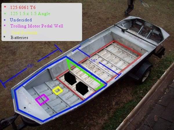

Ok, got the Steelflex in last week. Haven't considered applying yet, cuz it's been too cold! I was told that I needed to have air temps above 70, so It may be a while. In the meantime, I'm still trying to figure out how to layout the bow deck. The picture shows what I am trying to accomplish. I would like to have a couple hatches (or one big one) for the 2 batteries up front, but don't think I want any in front or to the side of the pedastal. I'm 270# and am nervous about standing around lids all day. So, with that in mind, let me know what you guys think about the best way to support the deck. Not sure yet if it will be plywood or aluminum yet, but the framing will be aluminum angle. Would also like to install a well for the trolling motor pedal as shown. Still waiting on the funds for the 6061 on the floor before I frame anything. That red piece of aluminum will be close to a 4 x 8. #-o The ribs are approximately 14" off center and the floor is about 42" wide at the green framing.
Here's a pic of what I had in mind
And here is an orginal if anyone wants to play with the layout. hint...hint....

Looks good.
couple of questions.
Where is the livewell?
What are you using for the deck material on the front deck?
Any thoguht to rod storage or gear storage (wet weather gear, life jackets, etc.)?
Looks like you have the space on the front deck for gear storage.

Hanr3 wrote:Looks good.
Thanks.
The livewell is removed from the pic, but it will be installed approximately 12" in front of the rear bench. There is a picture of it installed against the rear bench at the beginning of this thread. Moving it 12" forward, I plan to use that space to house the pumps for the livewell, a battery to run all the accessories minus the front trolling motor and depth finder, an oar, life jackets, etc.... and will probably mount my switch panel inside that space on the outside of the bench. I made two cut outs on the top of the bench which should make for easy access to my wiring when needed.
I'm still undecided about the deck material, other than the pieces at the floor that I will wait until i can afford the approximate 40 sq. ft of 6061 that I need. If I can afford aluminum for the bow and stern casting decks when it's time to do it, I will use it; however, it will probably be plywood until I can afford aluminum, so I would lke to frame it out to be able to transition to an aluminum deck with minimal extra labor involved.
As far as rod storage, I tried a couple times to design a box, but I felt like I would rather have the sides of the boat unobstructed between the bow and stern decks. I will put a couple of the bungee hold downs on the front and rear deck to hold the rods for when I trailer the boat. I guess becuase I haven't had one, I don't see the value in one yet. When I get home from the lake, I always take my rods out of the boat.
I've also considered that I may someday deck the entire boat level with the bow and stern, and would proabably incorporate a rod locker at that time. For now, I think I like the idea of having the low spot in the boat mainly because of my kids and I also think it makes a good area to put things if it's windy.

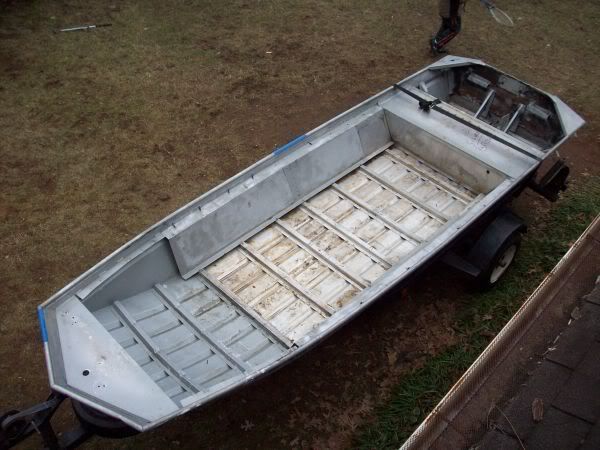

Well, haven't had much time or the weather to do much to the boat until today. It's a beautiful day here in GA today. I took the boat off the trailer to start doing some prep work for the steelflex. I had already done a leak test, and used the aluminum epoxy to patch a coulple rivets, a small hole, and a seam in the transom. The boat has a factory paint job on it, and despite being beat up (presumably in the river) the paint is on good. REAL GOOD :evil: .
Prior to sanding
Here are the areas that got patched prior to sanding
More to follow in a minute. Photobucket is being a pain in the neck :evil:
Rhyan Craft
What I thought would be an hour or so process with the angle grinder and a 40 grit flapper disk is going to take closer to 7 hours unless someone can tell me a better way of doing this. HELP! Just this part took about 1 hour!
Should this process take this long??? If I continue the same way, prep work will take approximately 7 hours worth of the angle grinder :shock:
Also, I noticed this area back by the transom that I assume the river has added "character" to.
Is it worth trying to pound these dents out, or should I just fill the low spots with a little more steelflex

I don't know if you really need to take this thing all the way down sanding like you're doing - I mean it's good... but I'm just not sure it's required. As long as you etch it a little that steelflex should adhere.
As far as the dents - it's on the bottom.... and unless it has thinned out the aluminum, I honestly wouldn't worry about it. You can put a little more steelflex there, but doubt it would make that much of a difference.
