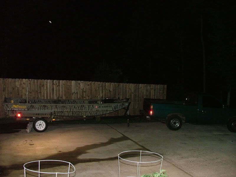

Ok.. so I'm going to transfer this mod into a new one....
Turns out, this boat is a 1999 model Xpress Boat by Alumaweld. And I do believe this thing may be too heavy to pull with my truck - but by God I'm going to try. I didn't bring it home yet, but I do have pictures. I forgot to look at the placard in the boat, but I'm pretty sure it's a 1546D model, but the length across the gunwhales was more on this boat.
Total Length - 15' (well... 14'6", but I think they call it a 15')
Floor Width - 46"
Gunwhales - 68-69"
forgot to look at the depth, but it's nice. There is a carpeted floor in it, and even though it's marine plywood, I'm going to take it out because I swear it was holding a ton of water and that might be part of the problem why I couldn't lift the tongue.
I'm going to pick it up later this week and the first thing I'm going to do is take it straight to a car wash and get rid of the mildew and trash.
Here she is.....
