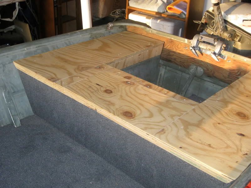

Sorry to hijack my own reply, but does anyone foresee any possible issues with this modified bench seat design? If I cut the top of the bench seat out but leave the sides, is that enough reinforcement to keep the sides of the boat from caving in or the ribs from cracking?
Take a look at this thread. When I saw that mod I knew it was exactly how I was going to do mine. Russ has it right! IMHO.
https://www.tinboats.net/forum/viewtopic.php?f=13&t=4493&start=70
Don't take the entire top off, leave a lip around the outside.
