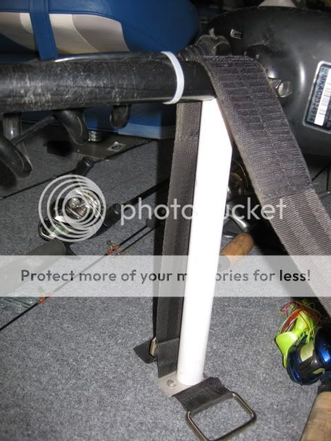

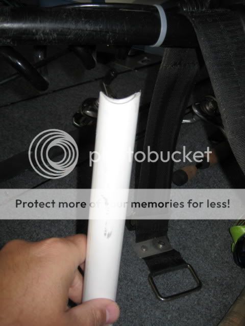

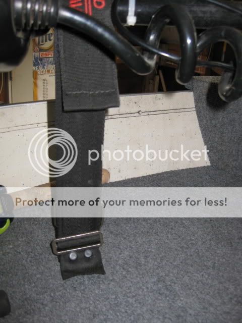

I use a Rod Saver strap and piece of PVC to keep the trolling motor from bouncing around while on the road and rough water.
I've notched one end of the PVC to fit the motor shaft then slide the other end over the screw head in the floor, and then tighten the strap with the Velcro.
