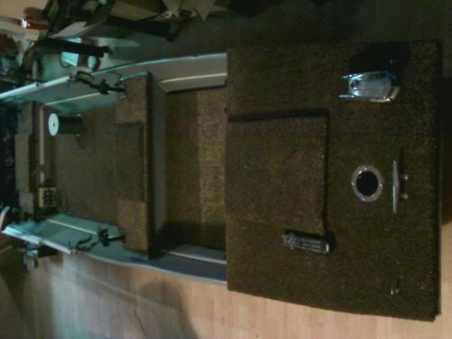

I started building the decks and stuff first only because it was way too cold outside and snowy to be able to work on the boat. LOL. I got anxious and ended up bringing the boat into the living room to work on it. At least the wife doesnt mind as she knows i do anything to get projects going. I get restless just sitting. Another note me and my buddy mainly fish Catfish on the rivers. Once i had the boat where i could work on it the first thing i wanted to do was test it for leaks as the dam took its toll. I filled it with water and marked it with marker where the leaks were. There were only 2 actual small punctures. One in a "V" channel up at the hull and the back corner was smashed in some and had a crack. I pounded the corner back out and sealed the punctures with some thick marine epoxy. Now to tackle the other leaks. I had 45 rivets leaking where the benches were attached to the boat. 3 were completely missing. I put 3 new rivets in there and thanks to this site i learned about Peening Rivets. Ill tell ya what. It worked like a charm. Took a lot of time but worth it. I then put 3 coats of rubber seal inside the bottom of the boat. Mostly as a sound deadener but im sure it will help as well to keep it sealed better.
Now it was time to make bench covers. Each of my benches has a cutout in it for my batteries. I did it last year so i just kept it that way. If i hadnt already did it i would have changed it to have one battery on each side of a bench to help stabilize.
Now i built the front deck. I used to have one go from bench to bench. I learned though with the benches only being 8" tall that left me with hardly any storage space so this time i decided to build the front deck on top of the rails. I had seen another post on here that gave me the idea. And boy did it improve storage. I then took a stainless sink drain and cut the bottom out of it and sunk that into the deck behind a cleat. That is for the anchor. All the rope will be under it in its own storage and the anchor will sit inside the drain when not in use. Perfect for mushroom anchors. Mounted an old bow light i had laying around and ran the wires through the deck. I made the framing out of light 2x4's and Polyurethane them for protection.

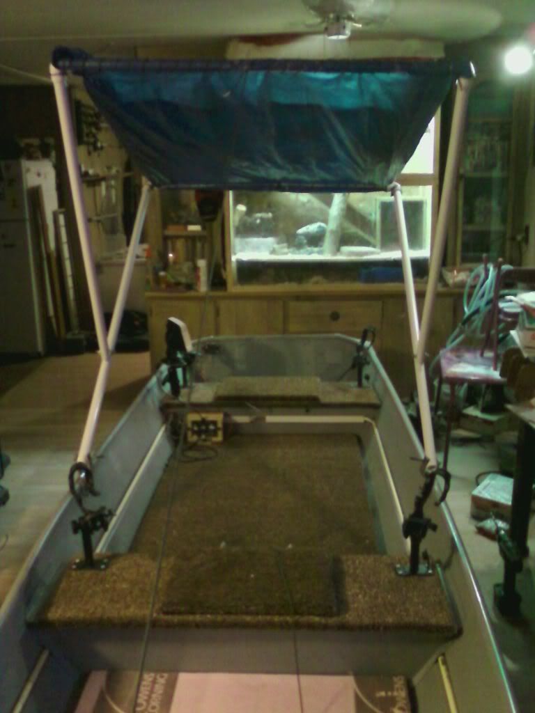

Now i cut some 2x4's to the width of the bottom. I then used a table saw to dado a 3/4 x 3/4 slot in them to place over the supports in the bottom. I put some seft tapper screws through them and into the supports. Then i cute Styrofoam to fit perfectly in between them so when i place the floor in it will all be even and rest on them for support as well.
Now I needed a way to run the wiring so i ran some 1/2" pvc down the channel on the gun-well from back to front. It fit just right behind the benches as well so no need to fasten it in place. I then drilled holes in it where wiring would be entering or exiting it. I also read on this site that wiring that comes in contact with the aluminum will eat a hole fast. Dont want that. So where ever wiring went into the aluminum benches i used 1/4" plastic fridge water line and ran each wire through that so it would never rub the aluminum and cut the wire insulation. I also used some cheap wire conduit for running the wire along the benches.
Now i laid the floor in and got it set. I made my own switch box for all my components and have some extra switches for later. I wanted the box close and also easy to access wiring if there was a need. I mounted it using a hinge that allows me to run the wires into the side of it and if needed i can tip it forward exposing the wire from the back. Essentially i ran a battery to it and made a common ground post to reduce wires running all over the boat. It will look a bit better when all the wiring is permanent but im not fastening all the decking down untill weather gets better and i can carry the boat back outside and get o good cover for it. So i need to remove it all or the boat would be too heavy lol.
Now i mounted the Ram Rod holders for my rods. Ill add more soon but only have 4 for now. They are actually sunk in through the deck and 2 inches into the bench so they will not move. Had to use an 1 1/2" keyhole saw. Worked great. I also mounted my new depth finder. Most may laugh at me for this but hey i like my toys. Its the Humminbird 789ci si side imaging. eww $1100 but ive been wanting one and figured id do it right. Besides side imaging on the river will be great as ill see completely from bank to bank with just one pass. I also used a Ram Rod mount for that as well so i can maneuver it as needed.

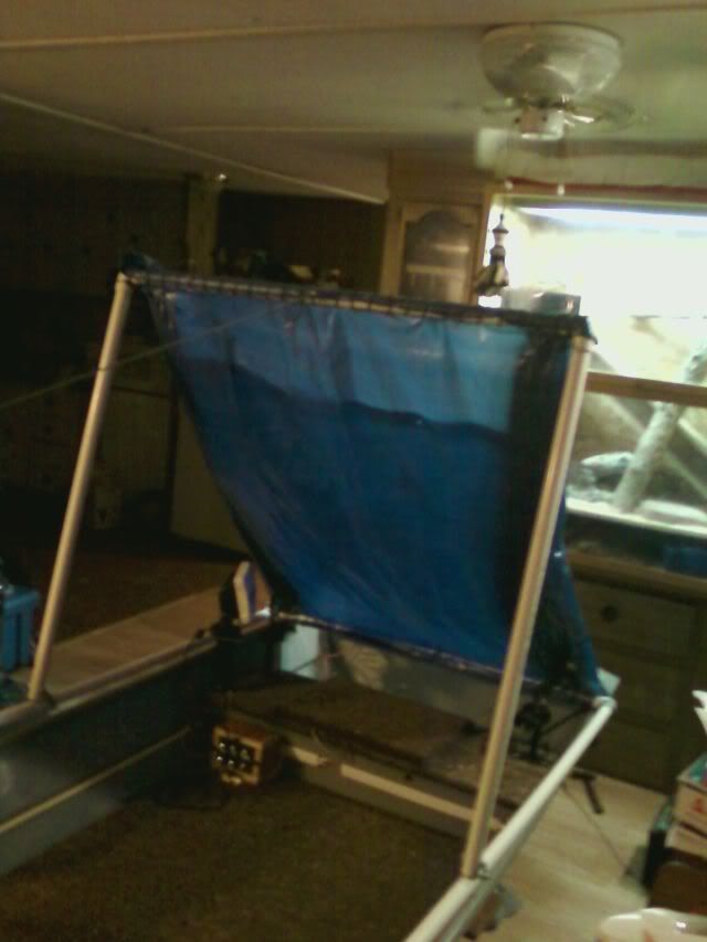

Thanks. Just finished the canopy. I built one for my other boat before so wasnt tough this time. Just smaller. Its made of 1" pvc. I mounted it to the boat in the oar slots. Sewed the tarp with 550 cord. When fully mounted it will have two cords that when you pull them it stands up to provide a sun block. As you pull further it will stand up completely to cover you overhead. This one is a bit more bulky because i designed it to be able to completely enclose us in times of storms and rain. If i pull the cords on the sides all 4 sides will roll down over the boat for cover. Heres a few pictures.

Finished the flooring and put eyelets in the front and back for the clips that hold the canopy in place.

Watchoo doin man? Using that thing as a couch? I see wood floor in the background and a tv remote in the boat...is it in the living room? LoL
RedneckCatter
Posts: 9
Joined: 16 Feb 2012, 21:52
Jesses 14ft 1970 Appleby Mod 2/18/2012
Post by RedneckCatter »
Yes sir. Way too cold here in Iowa right now and it was snowing. So i pulled it into the living room to work on it lol.
