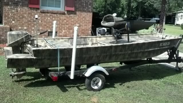

Here's a pic of the boat when my neighbor had it.
