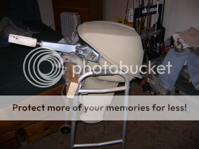

Well,almost done with the outboard.Have a side to paint tomorrow and then throw it all back together and start it up.I still had a broken bolt in the exhaust on the top that I forgot about.Had it about drilled out but ran out of juice in my cordless drill.Early tomorrow morning I will get that one out and start putting it back together.I'm going for the real camo look.I painted with 3 differant ultra flat colors.Will tye them all up with some stenciling when it is all together.
Here's the motor part with the half bolt still stuck in it.lol.
Here's the cowl painted a desert tan.
Here's the extension and the lower unit.See the differance in the colors?

How do you like the fishing equiptment room ??lol.That's my big Plano Saltwater fishing tackle box.And the Okuma saltwater fishing rod holder full of GIANT 80 lb. test Tuna rods.Still deciding what color to paint my prop.I'm thinking darker green with tan stripes,lol.

I see Grandma is still grounded since her walker is occupied.

I used all Rustoleum spray cans.That way if it got scraped up $3.48 would fix it.All the parts of this motor are aluminum,except for the cowl,which is fiberglass,I believe.I used 320 grit wet,or Scotch Brite pads in the red color.The motor was'nt all beat up so there was'nt any deep gouges or scrapes to sand out.It just looked crappy,lol.I was a prep guy about 30 years ago.Sanded lots and lots of cars.Doing this was fun,not them.Biggest thing is having a very clean surface with spray cans.And every bare aluminum surface has to be self etched.Especially the rivit heads that keep going bare if you sand then too much.You want primer on everything.No bare aluminum spots.AT ALL.3 coats of paint.Let them dry between coats until it fashes off to a flat looking before putting a second or thiird coat on.I've got 2 cans of spray paint on the motor,so far.Doe'nt take much.Will probably take three.I'm going to use clear coat over the top of everything after the stenciling is done.It's for looks and I like it,not for hiding from ducks,as I don't hunt.I think it is cool,lol.I'll show some before and after shots when it is done.
