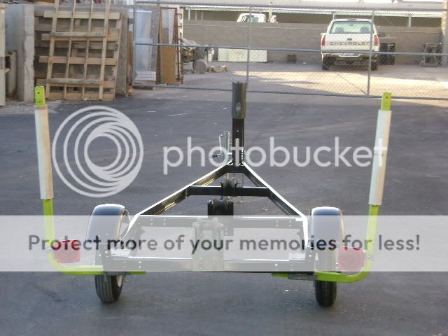

Ok Everybody,computer is back in action.I have lots of pics to show.I'll start off with the trailer that is done except for the bunks.The only thing that I am going to change is the fenders.I'm going to sand them down again and paint them with the camo to match the boat,then clear coat them.

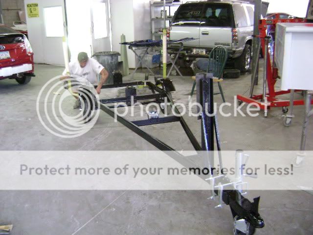

In the booth.All black inside and out of the frame.
Rollers installed
Put the rear guides on also.Bunks will be carpeted in black,and I have a new wiring harness for the plug and tail lights.

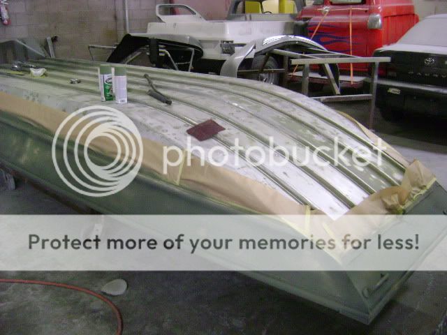

Post by SaltyBuckster »
Moving right along.Waiting on my Steel Flex,figured I'de shoot the top of the boat to make some lines to follow.The rest will be rolled with Steel Flex.
Self etching Primer

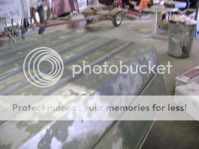

To anyone that has used the Steel Flex,what else should I do to the boat to make it ready to roll on?In the pitures it is machine sanded with 80 grit.I'm going to go over where the little circles of paint are around the rivits.I still have to paint the transom and strip the area where the Steel Flex will go across the back.It is already sanded and etch primed back there.I'm going to put some masking tape across the back inline with what is already painted and strip it down to bare aluminum.Any input on this prep ???

azslabber wrote:To anyone that has used the Steel Flex,what else should I do to the boat to make it ready to roll on?In the pitures it is machine sanded with 80 grit.I'm going to go over where the little circles of paint are around the rivits.I still have to paint the transom and strip the area where the Steel Flex will go across the back.It is already sanded and etch primed back there.I'm going to put some masking tape across the back inline with what is already painted and strip it down to bare aluminum.Any input on this prep ???
Looks good to me! The only thing you haven't mentioned was removal of dust. I washed mine with soap and water and then went over it with acetone on a rag after it dried.
I take a damp rag and wipe it down and blow it off before doing any masking.I know that it has to be wiped down with Acetone before the Steel Flex,so they told me.Is 80 grit heavy enough for this?Or should I go to 60 or even 40 grit?

Post by Henry Hefner »
Heavier grit cannot hurt, since the steelflex is so thick, but I think 80 grit is plenty rough. Then again, I'm not an expert, just a one-boat user.
