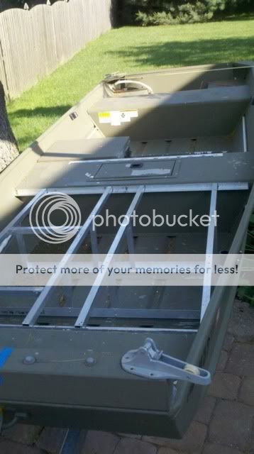

Made some significant progress on my build this weekend, been slowly working on it over time, but it's 3/4's of the way done.

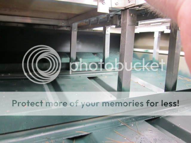

Front shot of frame work. used 1 inch aluminum box tubing along with 1 1/2 inch aluminum L angle.

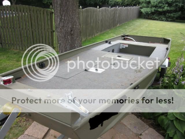

Deck installed. it's 2 pieces, 1 covers from bow to middle of the gap between front and mid bench, the other covers from middle of gap to the far side of the mid bench. both are 1/2 inch ply wood sealed with 2 coats of spar urethane. screwed down into the aluminum supports with 2 inch wood to sheet metal screws.
Hatches are also 1/2 inch ply, installed locks on both to keep the stored stuff secure when the boat is sitting in the drive way.

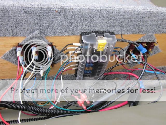

Early stage of the electrical, needs to be organized haha it's a mess at the moment. but everything works perfectly.

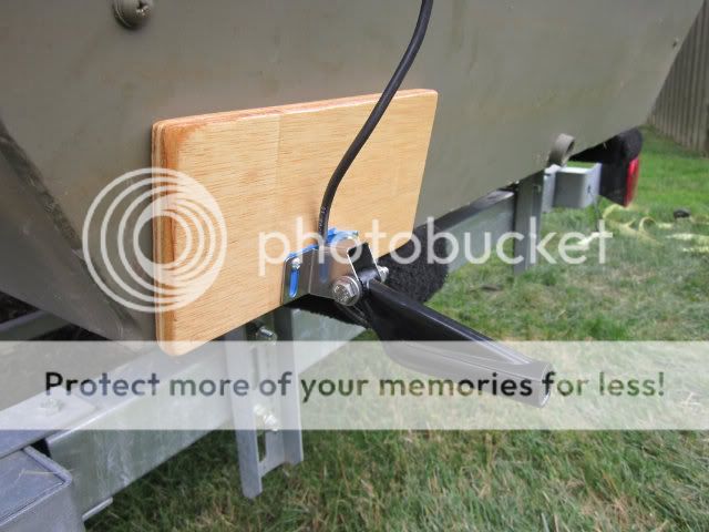

DSI transducer mounted on transom, board is sealed and marine epoxy-ed to the transom, feels very solid.

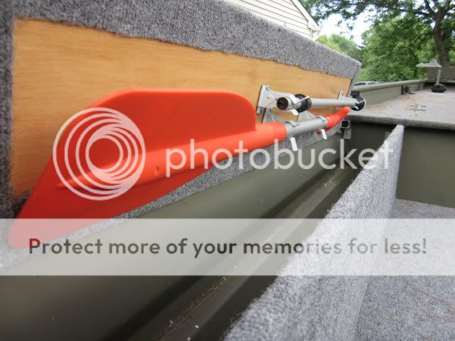

Left side box holds collapsible paddle and rear nav pole light:

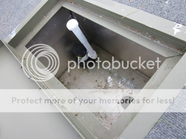

Aerator in live well, going to silicone around the hatch edge as whenever it pours the live well fills with water, most of it drains but as you can see some stays and becomes stagnant sometimes.

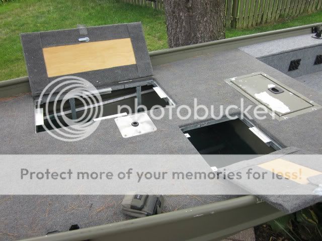

finished up the back deck over the holiday weekend:
Long shot of the boat:
Rear hatch closed:
Rear hatch open:
Back section:
still have a few more small things to do on it but that's a few weeks off.
Trolling motor comes on monday, decided to go with the 80# MK terrova with auto pilot and universal sonar 2. no idea how it mounts to the deck yet, anyone here have one that they can post up a picture or two so I can get an idea of what to expect? going to wire it all up when it comes, need to pick up a 2nd deep cycle battery for it though. speaking of which, I know you shouldn't use an older battery with a newer battery but unfortunately I can't find a battery manufactured in the same month as my other two that I currently have, both of which are a year apart. I can find one that's 2 months away from my newest one, is that ok to use them together?
