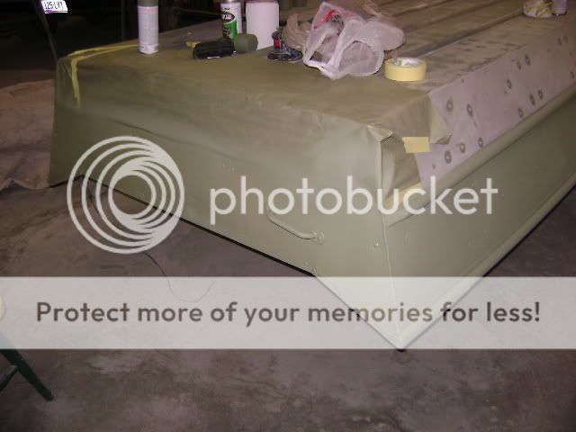

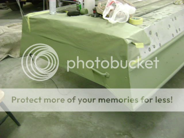

Spent a couple of hours dreaming of being done.Got the outside of the transom painted and stripped.Only Steel Flex left to finish the outside off.That is scheduled for next Saturday.
Ready for paint.
Everything else on the outside gets Steel Flexed in OD Green.

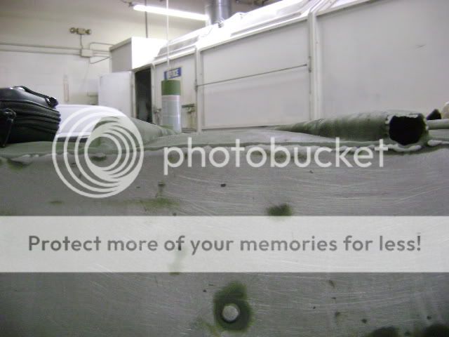

I'm going to metal finish these humps out on the flat side of the rear bottom.Hope that it works out.
Ready for paint.

And yes the drain hole is now round and the plug fits,lol.How important is it to get them "Humps" out of the bottom at the rear floor?Seems like whomever had this boat before sure did drop a lot of heavy things in the rear floor.

I never saw a hull with dents like that in the floor, usually they are pushed towards the inside of the boat from beaching!

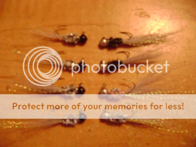

Had some free time today waiting on the Steel Flex,so I tied up some 1/16 oz. shad crappie jigs.I'll be in the trees gliding on through with my flat bottom boat yanking out crappie while everyone else just watches,lol.
I think that the "Maiden Voyage" coming up will be a great one.

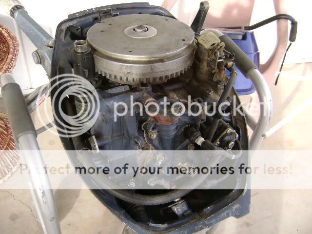

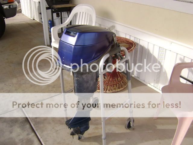

Look what I ran into yesterday.1969 Evinrude 9.5 9922S.Good enough for me for awhile.Started right up but does need a bucnch of little stuff.Been sitting for about 8 years in storage,so I was told.
Almost ready for a fishing trip.A couple of parts and a camo paint job and all will be good.

Looks like you got yourself a long shaft, not to common on a 9.5.
Anyway, I would change the impeller and lower unit oil since it's
been stored for a long time.
Here's one like yours purring like a kitten. Enjoy!
