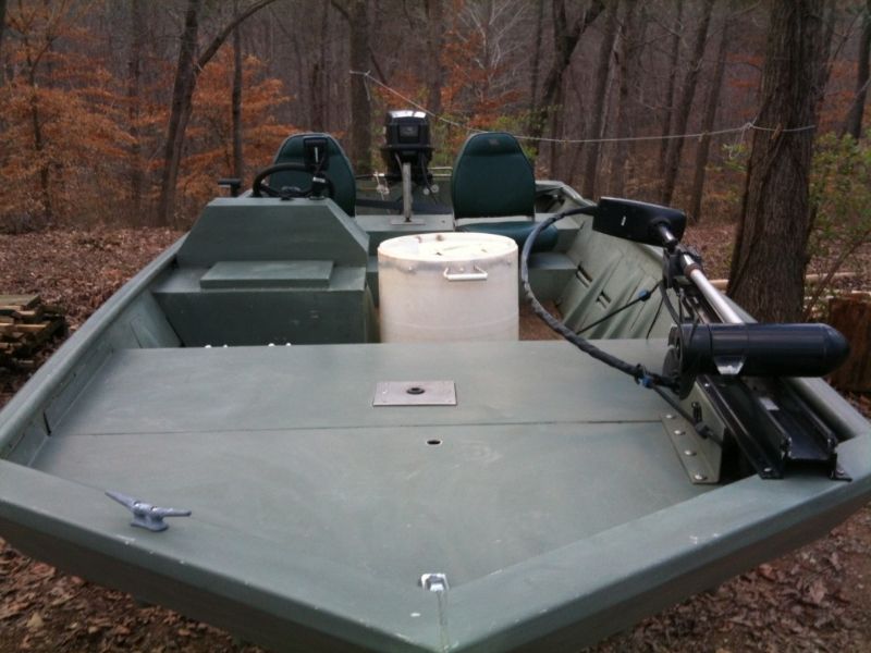

I have done a little more cutting an fabricating, I decided on a permanent location for the trolling motor, more in line
with where the original was. I cut a bigger hole in the deck to run wires inside pvc, from the trolling motor, under the
deck, a new hole in bulkhead, with pvc pass thru, then to the batteries.
I used the casting deck extension cut out metal to cover the base for the new trolling motor mount. I need to take pics.
I still have a little trimming and final fitting to do on this.

Sizing up the trolling motor mount, I used the original mount used with the old Motorguide screwed in its original holes, then sized up a piece of the bow deck that I previously cut over the top of it:
Rough fit the new base plate by screwing it into the original mount, it is not trimmed flush with gunwale, nor is it level with gunwale:
Lining up the trolling motor with long axis of the boat, I extended the plate to fill totally under the trolling motor mounting tray:
Notched out the bow rails, this gives some vertical area to mount accessories, LEDs, etc…
Mounted all in place, trimmed to boat lines, leveled with a piece of angle, and fastened with SS:
A little finish grinding and some painting to do, I also extended the angle to the same length as the original T-M mount, figure out what to do with it later:
Nice big casting deck with T-M, and new home for bait tank with a alien on top of it (filter prototype)…
Clean, open, boat well….
That open area between gunwale and original T-M mount is perfect for stashing rod tips (still on the rods), and you can see I recessed the T-M plug and added a 12 socket (going to do some more 12V distribution up here…)
