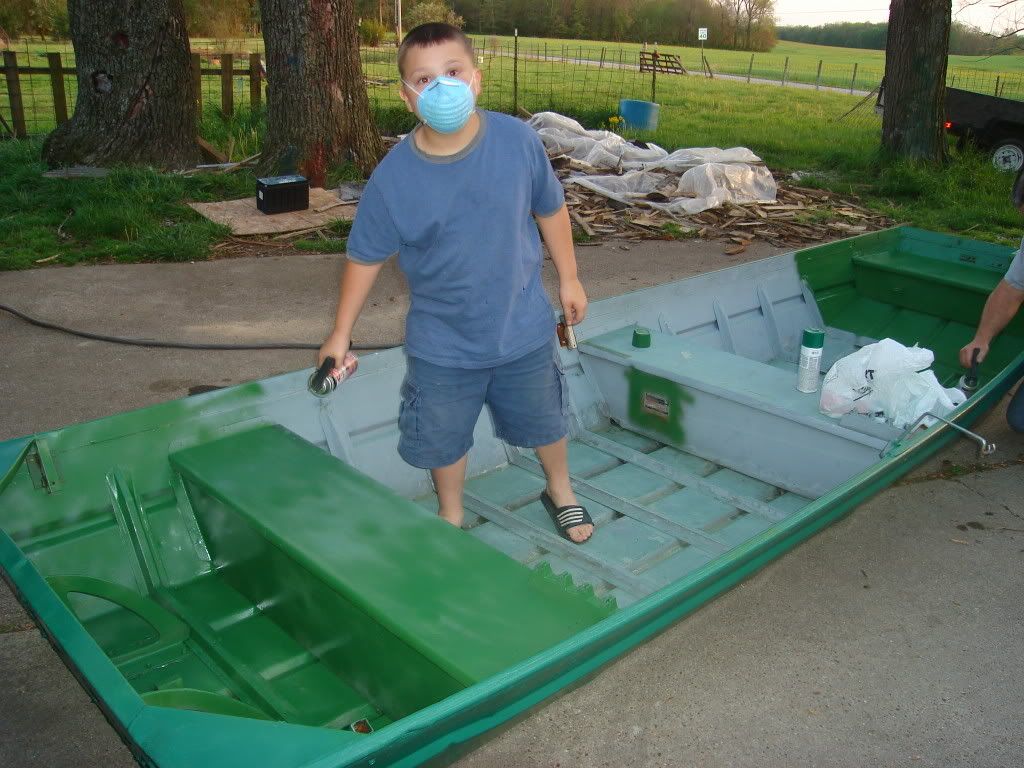

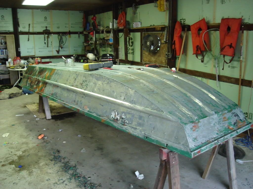

Hey all, I posted a little early but, its to get feed back on some Ideas and your do's and Don'ts on my first Jon project. What I should stay away from and what I should really do. Maybe some help on a floor layout?
This is what I started with
what I ended up with
As you can see Its Cramped
This is where I left off before I had to stop do to health
There ya go. So if ya got the ideas or questions post'em.
I'm wanting to be all electric, and intrested in depth finder, live well or ice storage and storage. I'll start there :) [/url]

Actually the last pic is the actual stage of the boat right now :cry:
So its a complete do over
I'm looking for Ideas on floor layouts and maybe some do's and don'ts
