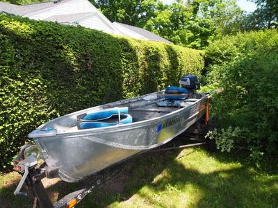

Well, finally went out and took some pictures of it, as it is now, before I do any sort of work on her. (Let's hope that I can get them posted right).
I took a few quick measurements and from bow to stern she is 13' 10", transom is 3' 11" wide & 1' 3" deep, widest point is 4' 4.75", depth at center bench is 1' 6".
Apparently when the guy I bought it from purchased it about 14 years ago, it was painted camo and he hand stripped that, and painted the inside with an industrial paint that had a bit of a grit to it (light bluish, you can see that most has already peeled off). There is one spot he discovered when stripping the pain where there is a Bondo patch, which must have been a dent as there is no sign of anything on the inside. There was a little seepage around a couple of the bottom supports, which was patched with marine fiberglass.
Well, keep the tips coming, and I'm off to read through more of your conversions for ideas!

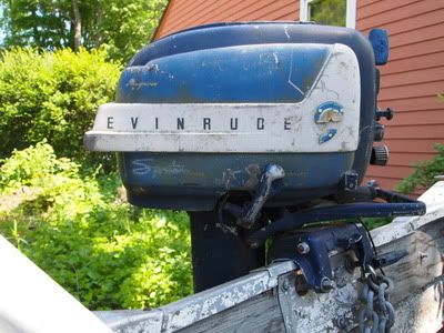

Evinrude 10hp

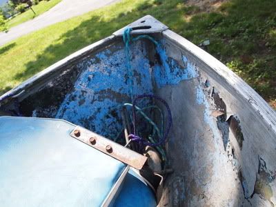

Inside paint peeling away...

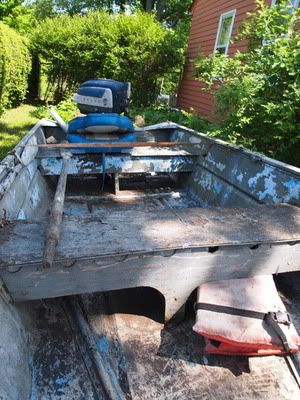

Undercoating starting to flake and peel...
